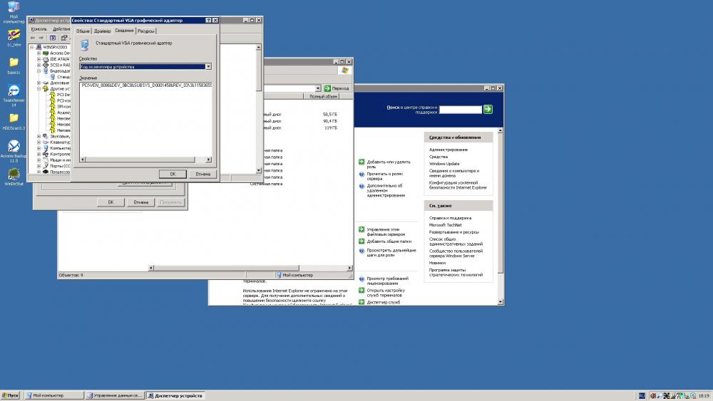

  10. @Mov AX, 0xDEAD вторая картинка ошибка Код 10 третья картинка ошибка Код 42 second picture is code 10 error third picture is code 42 error

  15. @Dietmar I will use this system mainly through rdp, so I don't have to worry about the drivers for the video card? or it will give a significant increase in work

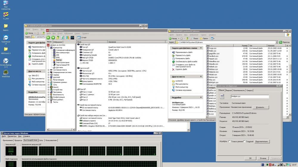

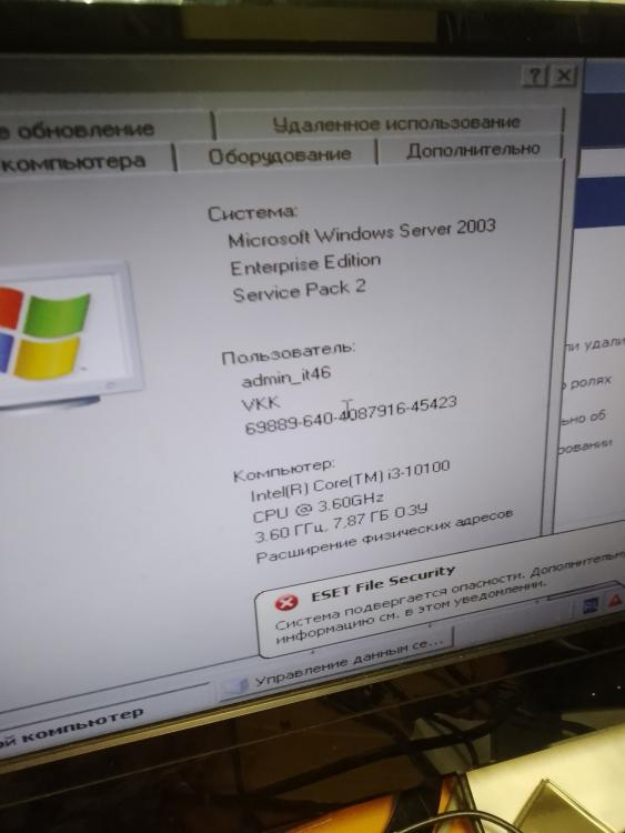

  16. @Dietmarthanks! I will wait for the intelppm.sys driver from you if you can do it!

  20. @Dietmar yeaaa, it worked! however, when using the system, which is on the i3 10100, or on the i3 7300, some slowdowns are noticeable. the final performance is still higher, but there are such moments. on core 2 duo was faster. I found the intelppm.sys driver, but it's for kernel version NT 5.1, but I have NT 5.2. is there a driver for version 5.2?
