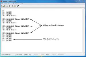

  6. well so may it be me reviving the thread. i've tried to read all but i got stuck on the first page. i dont got anywhere from endless loop of Rst 0x20M (P) SATA Reset LED:000000CC FAddr:0024CDC9 Rst 0x20M (P) SATA Reset and when i block contact of moterhead i get Rst0x20 ? i didnt find solution anywhere care to help guys.. my hd is seagate ST31000333AS and i'm using ttl to rs232 converter. thankx.
