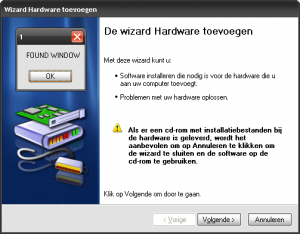

Sorry for the late response, I was very busy in the past weeks. But, I think I have success with your latest pro-s_test.exe The following windows appear when the script is run: So, what can you say about these results, is the problem now resolved? And could this fix be in your next release?
Drivers Instalation in Post-Install stage (New Method)
I ran both commands, but the outcome is like the screenshots I posted earlier. It seems that "Volgende", "Volgende >" and "&Volgende" doesn't work. What could it be, it looks like the button isn't recognized? Very strange
