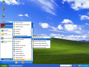

SUCCESS!! Just finished installing WinXP and Office 2003 from my USB!! Thanks to everyone on this thread for your help and information. I'm really doing this to continue to help me with my technical knowledge and to just to know I can do it! Will also be much helpful since my Desktop PC will not install from the CD/DVD reader. So, am I right in understanding that we first had to determine that the Batch.cmd had been modified by USB multiboot to nlite.cmd. And then, since we are installing from a hard drive, we had to modify the nlite.cmd to point to the U: drive for the USB in order to kick off the nlite.cmd and install Office?? I'm sure I'm probably not right in what I'm saying.... Thanks cdob for sticking with me the last few days. I did not find a source.log at C:\. Is there anything else you want me to try to do? mobes -
