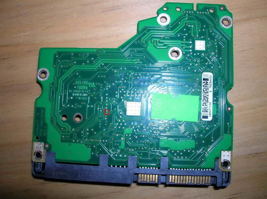

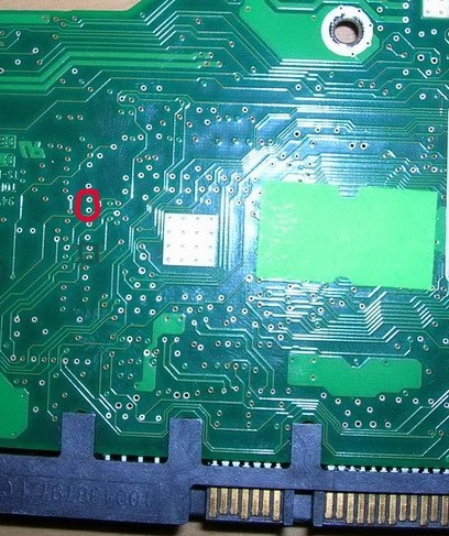

  4. Or this one? Taken from here which seems to be the same pic as number two (from Johnmars ES.2 thread) but with the red box in a different position. Johnmar seems to have touched his pic up from this one.
  5. z and Z are the same thing for the purposes of getting a prompt afaik. You can't do Ctrl+(hold Shift) Z or have Caps Lock on while doing this can you?. Typing 'Z' in level 2 is necessary to deliver the correct command, I'll give you that but it doesn't matter here and Ctrl+z did bring up the prompt just fine. Which pic is the correct set of shorts now is what I need to know now? I can't upload all the pics in one post though.
