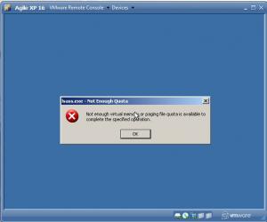

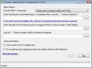

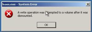

Hi John Thanks for the quick reply. Yes it is installed and working. It runs fine by itself and from within Nlite. See attached wmp11v1.4.2.0 I am running Server2008 as a workstation. Not had aNY problems with it being vista based before for nlite. However if you say it might be WMP11 Slipstreamer which is the issue I can try it without it and post back with my results. I am getting two errors it happens after the xp text setup stage just before it gets to the main XP setup stage. See attached error.jpg The two errors are... lsass.exe - Not enough Quota "Not enough virtual memory or paging quote is available to complete the specified operation" "a write operation was attempted to a volume after it was dismounted" Steve -
