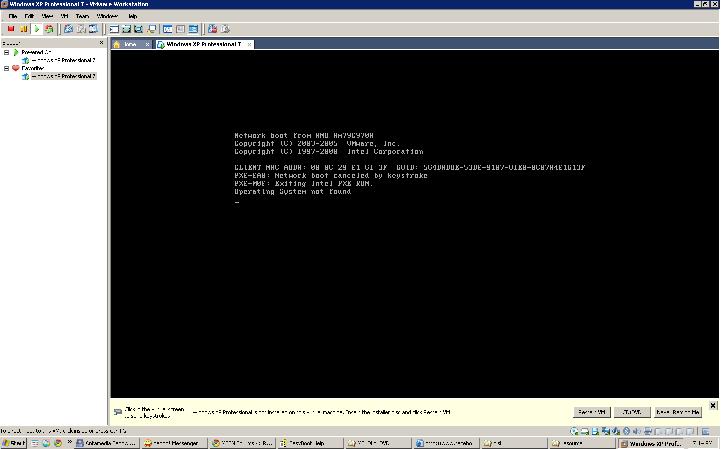

Guest chronoart Posted June 30, 2009 Posted June 30, 2009 help..!!! link your post was gone...!!! i have same problem... when i run iso setup in vmware error operating system not found..... please help me....
