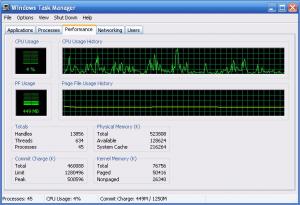

Metzen Posted August 16, 2004 Posted August 16, 2004 Are you running it in a virtual machine? If so, you might need to increase the RAM on it. Or, if your running it in a computer with low RAM you might get that message as well. Can you bring up the task manager and tell us how much RAM is in the system and what the PF usage is?
nychong88 Posted August 16, 2004 Author Posted August 16, 2004 Here is the Task attached.I am running in a computer, not in the virrual machine. This problem didn't occur before installing SP2.
