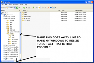

About your second and third post: Power - you already set power schemes in your reg file. Try applying manualy what you want, then exporting it... But I remember this was tricky.
Same about the size of windows - you already set this in your reg file. I think auto resize is not possible without some third-party program.
About the blue colour of right click: that's set in Display Properties > Appearance > Advanced > Selected items. I don't know about registry. Search for it.

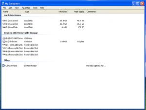

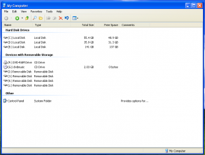

so i update my .reg version with most of the error and bug that ppl send or comment about it i still have bug like
i want to have this options activate in all screen like standard buttons and status bar i let you know with a screenshot of what i want i can set it manually but i want it to be by default so thank you

if someone can help me out with this:
-standards buttons activate by default ,
i want to only see in my control panel this 5 items:
