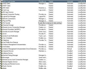

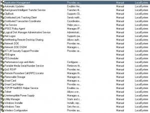

BigDaddy Posted February 27, 2007 Author Posted February 27, 2007 CLUBERTIAbout your memory dump I will do it next week when I get back here to this computer.The Event log service should not be causing such an issue and it's the only native source of logging for your system. However, if you could post a list of what services you have, and in what states something may pop out to someone.I still think you have a service looking for a network resource and is timing out. Can you duplicate the delay fairly consistently? If so, try coming up w/o your network cable connected to see if you still get the delay.This happens every time I reboot the machine with or w/o the network cable plugged in.I attach 2 screenies of my services ordered by status.I hope we will be able to solve this ASAP
