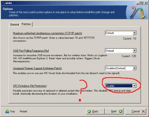

Also, you can disable SFC under Options/Patches. Here's a pic:
This takes about 10 minutes off the installation time, give or take. ;)

i did all you said about removing components as much as i can and i am using P4 3.4 GHz Intel Ram 512, i think its not removing components or Computer speed coz i did no thing for component and all most same time with nlite..
i hope its clear
