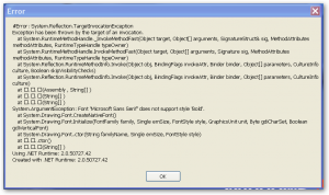

darkbolo69 Posted January 16, 2007 Posted January 16, 2007 Hello guys I'm having the following problem and I don't have any idea how to fix it, could anyone help me. Currently I have the latest NET framework 2.0 But when I ran Nlite this screen pop up #error:System. reflection. target invocation exceptionException has been thrown by the target of an invocationat system runtime method handle invoke method fast object [] argument etc.........Thanks darkbolo69
lokelo Posted February 25, 2007 Posted February 25, 2007 I'm getting the same error after a fresh install of nlite 1.3 RC2
nuhi Posted February 25, 2007 Posted February 25, 2007 Hm...So I take XP Sp2, fresh Windows with full Framework, nLite installer?Anything else? I mean of course it works for majority out of the box but I did have those errors during development so I won't dismiss you so easily.
jaynbe Posted May 12, 2007 Posted May 12, 2007 Same problem with latest v1.3.5 as with previous versions on XP ProSP2 .NET2
nuhi Posted May 13, 2007 Posted May 13, 2007 Well read the error report:You're missing Microsoft Sans Serif Bold font.
jaynbe Posted May 13, 2007 Posted May 13, 2007 Thanks, problem solved after replacing the corrupt font.I thought of another reason because the font wasn't missing but obviously corrupt.The program loads perfectly now. Appreciate the great work on this program. Thanks

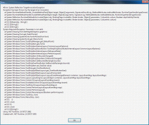

MCSammer Posted May 25, 2009 Posted May 25, 2009 Sorry to revive this forum, but I just got a similar error for the first time ever. I attached a screenshot for it.I read through the error several times, and I just can't seem to find anything that I could have cause, or know how to fix. any help would be greatly appreciated.
johnhc Posted May 25, 2009 Posted May 25, 2009 MCSammer, what were you doing at the time of the error? What nLite version are you running - should be 1.4.9.1? If you have a Last Session.ini, please attach (not paste) it. Have you run nLite successfully since installing it and .NET Framework? Good luck, John.
MCSammer Posted May 25, 2009 Posted May 25, 2009 Dear John,I was just trying to load nLite, to work on a project I've been working on for everyday for about the last... week. and I'm compulsive about getting the latest updates for everything, so it's not an out of date issue. and I tried installing, uninstalling, installing, it but same error. idk, let's just say that this is by far the best thing that's happened all day, so I'm kinda irritated.
johnhc Posted May 25, 2009 Posted May 25, 2009 MCSammer, you did not answer my questions about nLite/.NET working before. Did you remove/reinstall nLite or .NET or both? Several posters have reported strange .NET problems and these were cured by removing/reinstalling .NET. Did you check the MD5 for the nLite you DLed? Did you DL it from the nLite web site? More information is always better than less. Are you running under Vista, as your information indicates? If you are ultimately going to create an ISO for XP, under Vista you will not be able to integrate an SP. Enjoy, John.
MCSammer Posted May 25, 2009 Posted May 25, 2009 A. It's XP 32-bit SP3 with a win7 skin (The image is)B. I downloaded it from the nlite website after it was released.C. Would I uninstall 3.5, 3, 2 sp2, and 1.1?D. Yes it was working, hence the "project I've been working on for a week"E. It worked yesterday, and it finished making an ISO, which unfortunately did not work (Tested it using VirtualBox)F. I hope I don't seem to, PO'ed, it's been a poor day, as I mentioned before, but I don't mean to take it out on anyone.G. I did delete a bunch of fonts I don't use (about +1500 of +3700) earlier today, so I want to call that the culprit.H. Thanks for your help.
johnhc Posted May 25, 2009 Posted May 25, 2009 MCSammer, if you have created an ISO before, I would not, at least at this time, be removing/reinstalling anything. Did you remove the fronts from your Windows source? Is your Windows source a legal copy with a legal key? Please go ahead and attach one of your earlier Last Session.ini files? Now here is my normal inculcation, please make sure to always start with a fresh copy of your CD files/folders, do all your work in one nLite session and integrate only one SP. Please report when you have a solution, so others can benefit. So, starting with a fresh copy of your source (unaltered), try again. What kind of problems did you have with the ISO you cut? Enjoy, John.
cpuwhiz11 Posted July 9, 2009 Posted July 9, 2009 I just wanted to add that if you cannot find yourself a copy of Microsoft Sans Serif Bold font that installing Microsoft PowerPoint Viewer 2007 Here will give you a copy. This is what I had to do and it solved my problem.
