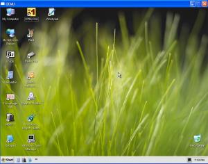

Nuno Brito Posted January 8, 2007 Posted January 8, 2007 Normally I would recommend trying the version 052 found here:http://www.boot-land.net/index.php?ind=dow...view&iden=2It's a ~3.7Mb download wich already includes the script created by holger ("MiscSettings.Script")At this moment I recommend you to download the latest beta of version 053 mostly because you can use it to download the latest scripts directly from our download server.From there you'll find the liveXP project wich contains the referred script you need. Configuration for livexp is simple - Add the path to your windows install CD files and then press the play button to see the results, resulting in a 51Mb ISO wich looks like this:Better use a retail version of XP SP2 - preferably not slipstreamed on nlited - or use a windows 2003 to enable automated ramboot.Let me know how this works for your goals..
