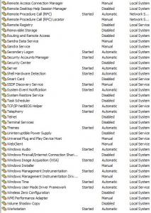

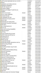

Marthax Posted November 22, 2006 Author Posted November 22, 2006 Of course, here it goes.I didn't know a better way of posting them than by using screens.
LLXX Posted November 22, 2006 Posted November 22, 2006 Do you really find it that difficult to look through the list of services and use your common sense?
cluberti Posted November 22, 2006 Posted November 22, 2006 I honestly can't see why you would have trouble starting the Sandra services unless they have dependencies on one (or more) of the disabled services. However, since Sandra is a performance tool, perhaps setting the Performance logs and alerts service back to manual will help?
Marthax Posted November 22, 2006 Author Posted November 22, 2006 @LLXX: What's your point? Those services are set to manual which means that they will be enabled when needed and I have not touched them since I tampered with my services when I didn't have Sandra.@cluberti: Set to manual, but not difference. It shouldn't either. Performance and Logs is a completely different story.
LLXX Posted November 23, 2006 Posted November 23, 2006 @LLXX: What's your point? Those services are set to manual which means that they will be enabled when needed and I have not touched them since I tampered with my services when I didn't have Sandra.Tried starting both of them first? I know that some apps don't start the service themselves if they're not started and set to Manual, they just wait and timeout because the service was never started in the first place.
Marthax Posted November 23, 2006 Author Posted November 23, 2006 I try starting them, but they deny the startup. I've changed them to automatic, but that yields the same message.Could it be that my Windows got screwed up somehow? Is there some other way to solve this besides reinstalling Windows?
