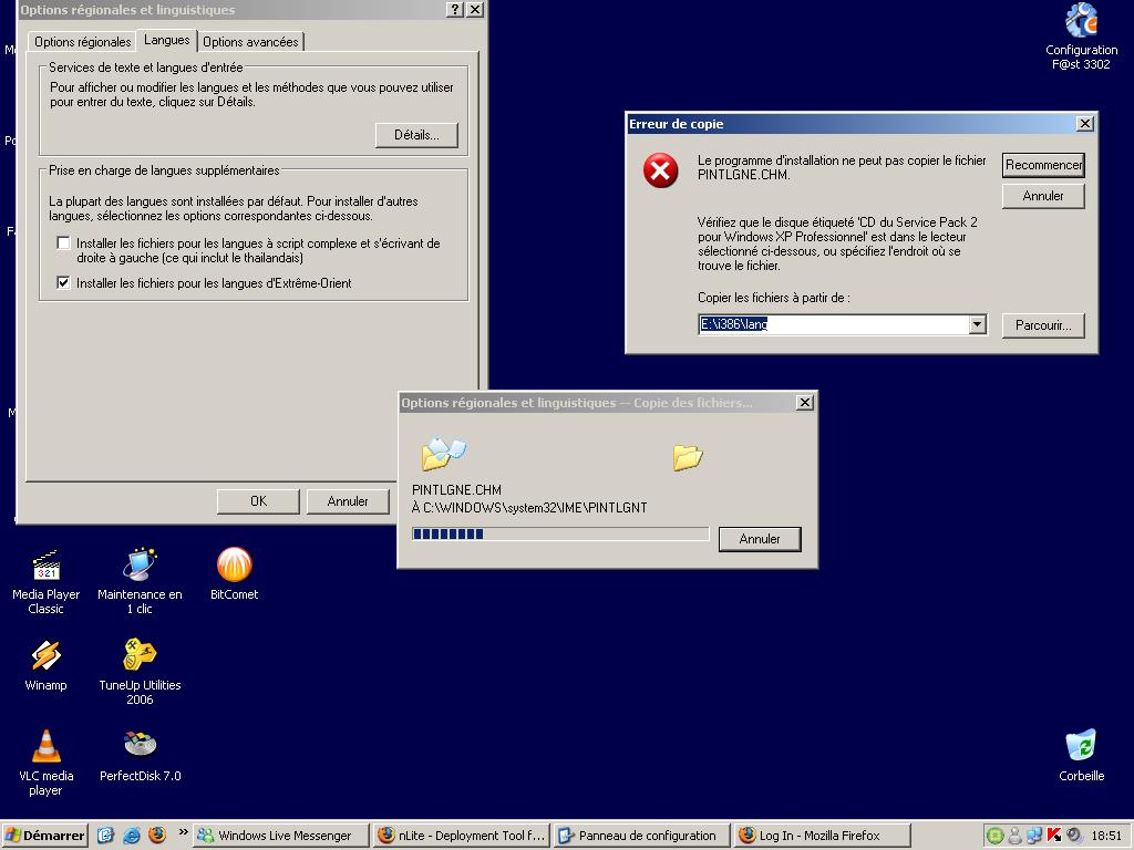

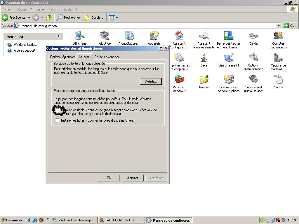

Hi,
i don't know why i can't install support or language package for arabic and chinesse (10 Mo+230 Mo)...i test with nlite 1.0 and nlite 1.0.1 and i have same probleme (DLL required when i pute cd)......but i don't have this probleme with nlite RC8 with SAME CONFIGURATION :unsure:
anyone can resolve it or have same probleme ??

For starters tell me how to repeat this issue exactly and attach (don't copy-paste) your preset used.
Also tell me at least first missing file reported and do you boot or run windows setup manually.

i boot with cd that i create to install xp

I just tried it and it went fine but:
- I used English Windows, yours are French (contact me via PM to send me few needed files to check)
- Did you maybe delete i386\LANG folder prior using nLite? (you shouldn't do this, let nlite remove it)
