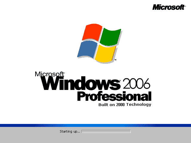

and next to that i have a modified bootscreen inside ntoskrnl.exe

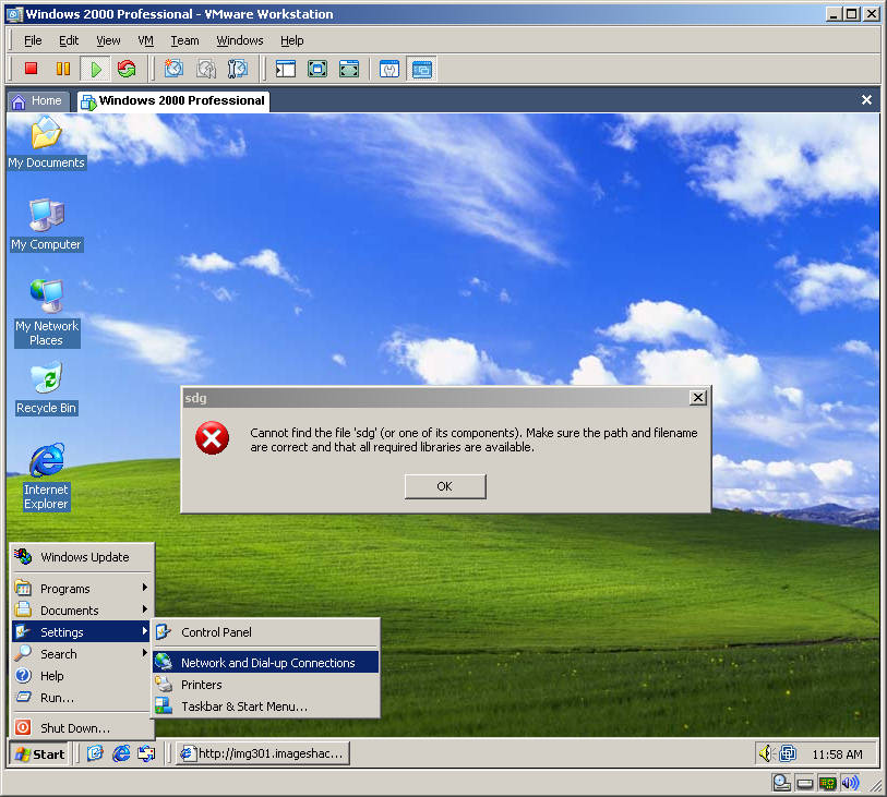

ive added a screenshot of how it looks.

sth wrong with ntoskrnl.exe,,
be sure u have just changed the bitmap but not alter with version and HEX editing.
were u able to login into safemode ?
try once without ur modified ntoskrnl.exe
Edited by Nepali
  • Author
i only replaced bitmap 1 with reshack, i assume thats ok?
u have done in perfect manner,,
but try booting into safe mode first,,
have u checked in ur hardware or just in vmware ..
