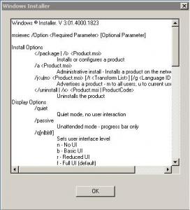

I tried running some commands that I found on other webpages but all they do is make a "Windows Installer" box appear containing some various switches and options that you can use. I tested the installation process at bootup and it's still not pushing v7.0.7.

I have tried running the following commands, and all that happens is a "Windows Installer" box appears and then disappears when I hit OK (see attachment). Any ideas? Thanks.

initially itried with msiexec and got the same window that u posted above. now it does nt
