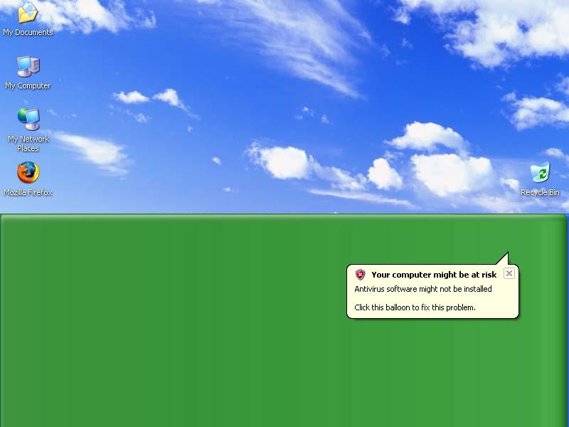

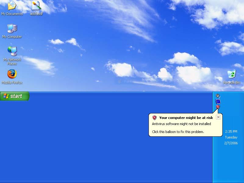

I have been working on my Unattended CD for a couple of weeks now and its been coming along fine. However, I must have changed something recently because now when it logs in the taskbar takes up 50% of the screen. Does anyone know why it is doing this or how to fix it?
The picture that has the all green toolbar is right after the install finishes. The second picture is what appears when it is restarted.

As far as i can see the quick launch bar is disabled in the screenshots? You did this on purpose?
