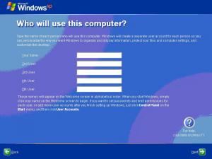

Guys!
Is there a way to entirely avoid user creation screen using oobeinfo.ini or any other file?
