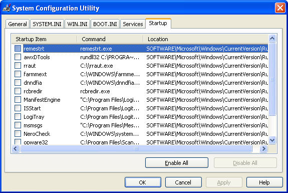

all my startup programs fail to run at windows start, when i run msconfig, the startup tab only shows the one that i disable before, all the one that were set to run are missing. I dont know what is wrong.

I'm using Windows XP sp2, there are several services and programs are set the run at system start, like the antivirus and the hotkey for my keyboard, but after the incident, all these programs and services did not run at system start, the only icons i see at the bottom right now are the volume icon and connection icon.

On Run type regedit and go here:
HKEY_LOCAL_MACHINE > SOFTWARE > MICROSOFT > WINDOWS > CURRENTVERSION
Inside these folders:
1 - Run
2 - RunOnce
3 - RunOnceEx
4 - RunServices
Look for the programs u need. If they arent there ... Just add them to Run!
Cya!

I saw a folder "Run-" that contain all the programs(with path) that were suppose to run at system startup, what should i do now?
  • Author
do i need to delete this "Run-" folder after i copy the file?
  • Author
never mind my previous post, i have fixed the problem, thanks Gouki.
one more question, how can i remove those disabled startup service in msconfig's startup tab?
The entries have to be in one of the 3 folders I mentioned. Just look for them there.
Didn't know about that Run- folder ... I think its safe to delete tho.
The Run- folder is just the place msconfig puts the keys so they can be later restored. It is a clever trick which I use often when disabling keys that I might want to restore later. That way they don't get really deleted just made non-functional.
