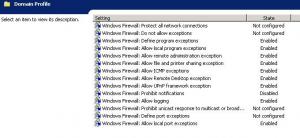

Bad boy Warrior Posted April 7, 2005 Author Posted April 7, 2005 ok i did that and have still some issues (same event id still logged in my client machine) ive set up the domain profile as in this picture - so what am i doing wrong? do i have enable something on the client machine?thx
valter Posted April 7, 2005 Posted April 7, 2005 ok i did that and have still some issues (same event id still logged in my client machine) ive set up the domain profile as in this picture - so what am i doing wrong? do i have enable something on the client machine?thx<{POST_SNAPBACK}>Well you need to enable the very first option, otherwise firewall is not working ... and don't forget to update your gpo, open cmd and type gpupdate /force on both the server and the client ...
