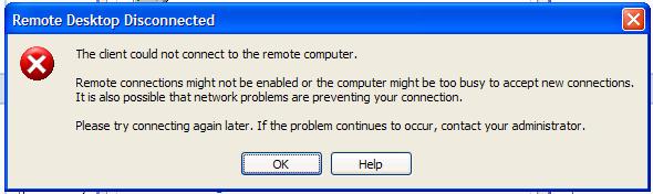

I set up Remote Desktop connection for my server when i use Computer 1 to connect to my server using Remote Desktop theres NO problem. Computer 1 is part of my network.
Before i go to my friends house i do the following i check on www.myipaddress.com to see what my IP address is (my ISP provides dynamic IP adds) and leave the server on.
Now i go over to my friends house and try to connect to my Windows Server 2003 (my server has a static IP address thats assigned from my router) using Remote Desktop Connection -
i type in the IP address that i found before going to my mates house. my username (part of the administrators group and have used the administrator account) the password and then my domain name (domainName.com) (i know thats bad naming)
I try to connect - it returns the following error:
(See jpeg)
So i decide to disable the firewall on my Router - still get the same error. I try to connect to the IP add only without typing in the domain name and get the same problem.

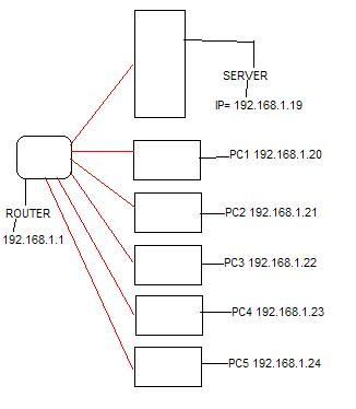

i have also included a jpeg to give you an overview of how i have things setup.
RDP uses port 3389. Your router must forward to that port on your Win2K3 machine.
i forwarded this port to 192.168.1.19 (see jpeg) which is my server. I did the same with port 1111

looking at your setup and from what you said if you can connect to your router's home page that would mean your routers configuration is incorrect - you need to change this to your servers address but leave the default gateway the same on your PC(s)

Ok just incase someone comes across this problem then you may want to use Remote desktop rather than the web based version. I tried to use the web based version and had all these problems that ive described but the minute i used remote desktop i entered my ip and domain and almost fell off my chair (errrrrrr as in i saw the login screen)
