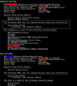

Dell and Rodney Posted January 24, 2005 Author Posted January 24, 2005 I started over my Group Policy again and have thye same result (policy not taking affect) so i ran the gpresult on WS2003. I think the yellow highlight is where the problem is but not sure how to resolve it.......the red marks are my computer name - any ideas anyone?CheersEDIT: If this is of any help it seems that ANY user i create has the same policy (even administrator account i created). In active directcory under the computer folder it lists my computer that im logging on with and not the server - is this correct?EDIT 2: If i right click my domain and select properties shoudl my GP be listed in there?
valter Posted January 25, 2005 Posted January 25, 2005 Well it looks like nothing hasn't been applied, at least that's what it says in the gpresult report. Anyway if your default domain security policy on certain GPO is for example set to ON, and OU GPO is set to OFF, the domain level policy will be applied, so make sure that there is no conflict between domain GPO and OU GPO (even though you SHOULDN'T change default domain policy, but only create your own new policies) ... if this doesn't work as well, there is only one thing left (without puting up a case w/ MS) reset security policies to default level. I know that there is a tool from MS that resets sec policies to default level. I don't think you can just download it, but you have to call MS support and ask them to mail it to you ...
