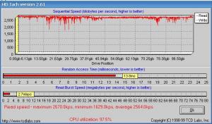

XPerties Posted October 28, 2002 Posted October 28, 2002 what defrag tool are you using?Is both your drives set DMA enabled?Both 7200 RPMS?When unraring whats your Proc% at?and do this, run this test..http://www.voodoofiles.com/home.asp?Item=1813Ill get you on MSN to talk further
XPerties Posted October 28, 2002 Posted October 28, 2002 ok as stated on the website:A 7200 rpm drive has a rotational latency of 4.15 ms on average. A 4500 rpm drive has a rotational latency of 6.67 ms on average. So a 7200 rpm drive with a seek of 12.5ms has an access time that is just as fast as a 4500 rpm drive with a seek of 10.0 msalso your CPU Ultilization should be low. See my screenshot for comparesent as I aslo have a WD
XPerties Posted October 28, 2002 Posted October 28, 2002 dude your max read, average and CPU is way wacked...something is really wrong and I would have to say its the drive. Your CPU shouldnt be over 20% and compared to my reading your EXTREMELY to low. Get the drive to WD for a warrenty check.

Aaron Posted October 28, 2002 Posted October 28, 2002 From your screenshot, it looks like your WD drive is using the CPU resources (97%!!!) to transfer files. This means your HD is not in UDMA mode, and instead, it's using PIO.Check your device manager, into the properties of your primary IDE channel (or secondary, wherever you installed it to) and see what mode its running in.You also need to make sure its jumpered correctly, and the cable (black end is master, and grey end is slave). Another tip is never put a 7200rpm alongside a slower hard drive on the same cable otherwise it operates at the slower hard drive's speed.
sedative Posted October 28, 2002 Author Posted October 28, 2002 It's running in UDMA mode, jumpers are fine, cables are fine, and they're both 7200 RPM.
