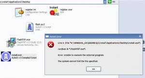

jamesas Posted December 30, 2004 Posted December 30, 2004 hey i cant get it to work but im using Aut2exe v3 would that matter
a06lp Posted December 30, 2004 Posted December 30, 2004 hmm... i'm also using v3did you create the script, and then use "compile script to exe"?make sure to replace the key with yours.also, make sure there aren't spaces in your key...
jamesas Posted December 30, 2004 Posted December 30, 2004 yeh i made a exe out of it and named it install.exe, and would it matter if its on one line
a06lp Posted December 30, 2004 Posted December 30, 2004 huh?the script looks in the registry to find the path where FlashFXP is installed. it then runs FlashFXP and simply pastes the code.you must make sure flashfxp is INSTALLED, and THEN run the exe...i don't understand the error..
benners Posted December 31, 2004 Posted December 31, 2004 Good job I checked here as I didn't get a reply notification. For those who downloaded my zip I found a bug when pasting the key in, if there was info on the clipboard, ctrl V, which is the key press sent, would not paste the correct info, so I use the paste clipboard button, I re-upped the new version.@jamesaswhat was the file name?. If any of the apps I install unattended need an ocx file I add it to $OEM$\$$\system32 and it gets copied across, then register it if it needs to be with regsvr32 /s followed by the file path and name.
