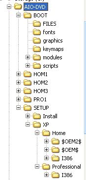

but how can i have option 2 work, it doesnt want 2 use my
OemFilesPath = "\SETUP\XP\HOME\$OEM2$"
im assuming this code doesnt work as it should since its not being used :P
keep in mind tho, the directory structure is as the picture shows Ive Only Started on home

OemFilesPath is the path to your $OEM$ folder.
That would mean?
OemFilesPath = ".\SETUP\XP\HOME"
If this is the case. The you cannot have 2 $OEM$ in the same directory. So you could put 2 directories into that directory, then put each $OEM$ directory into each new directory that you just created.
-I386
-Dir1\$OEM$
-Dir2\$OEM$
Winnt.sif entries would be
OemFilesPath = ".\SETUP\XP\HOME\Dir1"
and the second winnt.sif
OemFilesPath = ".\SETUP\XP\HOME\Dir2"
This may work?

correct, but instead of having 3 directories of "home" why not have 2 sets of $OEM$ which is smaller & cleaner looking IMO
I am not sure how you would do that, how would the OS know which OEM folder to use? OK you can set the drivers in the winnt.sif but what about anything else such as $$, $Docs $Progs folders that are automaticaly copied to where they are needed.
You would probably have to hack a few files or am i wrong at this assumption..
  • Author
ive opted 2 just use a second "Home" folder :( ill optimize the iso so it doesnt take any more room, but it'll be a b***h 2 keep organized lol
