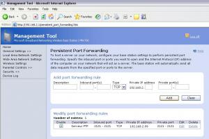

You have to tell ur gateway/router that every request on port 2121 will be redirected to your server ip.
by exemple:
My IP is : 24.200.200.35
My FTP server IP is: 192.168.2.99
My FTP server is listening on port : 2121
look at the picture
I don't have those options in my IAD........
Port Range..............
Protocol.................
DEST address........
Only!!!!!
