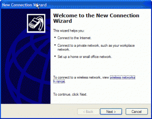

Astalavista Posted October 27, 2004 Posted October 27, 2004 Hi guysI have a wireless network access to the net.I have been using the same code REG ADD %KEY%\028 /VE /D "Download Accelerator v7.2" /fREG ADD %KEY%\028 /V 1 /D "%CDROM%\Software\Dap\DAP7.2.exe /s" /fREG ADD %KEY%\028 /V 2 /D "TASKKILL.exe /F /IM iexplore.exe" /fREG ADD %KEY%\028 /V 3 /D "PSKILL.exe dap.exe" /fbut i get this pop up... i don't know how to get rid of it.
totoymola Posted October 27, 2004 Posted October 27, 2004 That is because the driver for your wireless connection thing is not installed yet, so when IE starts, it can't connect. That's why you get that connection setup screen. You can just ignore it and the setup will still continue.
totoymola Posted October 27, 2004 Posted October 27, 2004 You can also add this. This might work.taskkill /f /im rundll32.exe
