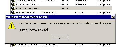

Hi guys,
I'm trying to see properties of one service on my win2k server. Also, I'm logged in as local administrator and error message pop-up with "Error 5: Access is denied.". I didn't try to restarted yet, because is busy almost all the time. But, I arranged to restart it today but I think that wouldn't solve my problem.
Any comment on that one? :(
Also this is error message...

You could try using Microsoft's delsrv.exe utility from the Resource Kit to delete the service and then reinstall the application package that installed the service to see if that clear's up your error. OR
You could uninstall and reinstall the application itself to try and get the service to install correctly.
It kind of sounds like the installation did not complete successfully to register the service on your system.
