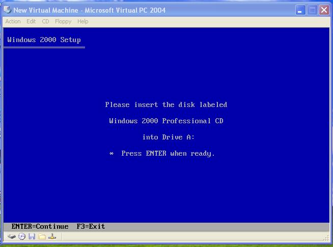

johnmallan Posted August 8, 2004 Posted August 8, 2004 Any one know how to stop the attached screen from appearing?
Tweek Monkey Posted August 8, 2004 Posted August 8, 2004 I had that happen to me once. If I remember right, it had to do with the HDs not being installed right. Check the jumpers and the IDE cables.Also double check to make sure the drive is good.
MCT Posted August 8, 2004 Posted August 8, 2004 this is fairly common i think.. its not caused from any bad hardware.. its something 2 do with the winnt.sif file i think.. search the forumregards
johnmallan Posted August 8, 2004 Author Posted August 8, 2004 Well it cant be the Winnt.sif, since there isnt any, and i dont think its the hardware, as iv tried it on two pcs, but ill double check it anyway.
LiquidSage Posted August 8, 2004 Posted August 8, 2004 if you made a win2k cd yourself are these at root?CDROM_IA.5 -if adv. server build CDROM_IP.5 - pro buildCDROM_IS.5 - server buildCDROM_NT.5 - probably the file you do not have at rootcdromsp4.tst - needed for a lipstreamed ver w/ sp4 (if you slipstreamed sp2 or sp3 before sp4, you will need to include the cdromsp file for that version as well/READ1ST.TXT README.DOC spnotes.htm
johnmallan Posted August 8, 2004 Author Posted August 8, 2004 Well i was missing some files in the root of the disk (CDROM_IP.5 and CDROM_NT.5), and the pc it was to be installed on had a loose IDE cable for floppy.Thanks for your help.
