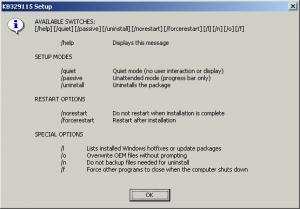

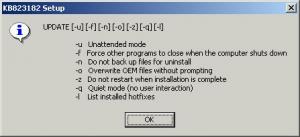

Maelstorm Posted July 23, 2004 Posted July 23, 2004 Seems there are 4 different sets of switches that hotfixes use in addition to Type 1 and Type 2. There doesn't seem to be any ryme or reason as to which set of switches that the hotfixes/recommended updates use. I'll list all the sets that I have discovered here.These are the ones that we know about:Type 1: /Q /N /O /ZType 2: /Q:A /R:NAnd now the ones that we don't know about:Type 3: /O /N /quiet /norestart Critical Q828741.EXE Q835732.EXE Recommended Q826942.EXE DX9 Update Q839643.EXEType 4: -u -o -n -z Critical Q824105.EXE Q810217.EXE Q811114.EXE Recommended Q822603.EXE Q821253.EXE Q820291.EXE Q814995.EXE Q322011.EXE Q327979.EXE Q810243.EXEOther interesting things that I have found:HighMAT Support package uses /Q /N switches only. Supplying anything else will result in a error. It does install correctly from svcpack.inf.The .NET package uses a similar format to the MDAC update. Here's my command line in svcpack.inf: "DOTNET11.EXE /C:""install.exe /qb""/Q:A /R:N" That /qb switch to install.exe does not appear anywhere in the help. I found it using strings on the install.exe file.The Help & Support information update uses only 1 switch for silent install: /Q.I'll post more as I discover additional switches.Later.
Alanoll Posted July 23, 2004 Posted July 23, 2004 I should point out...you're slightly incorrect. There is not a type 4 hotfix yet, as that is about to start beta testing.type 3 is only in ONE hotfix, and the only difference is a /integrate switchthe switches may look different in your "type 3" and "type 4" but they are truly the same. Notice the only diffence between your "type 4" and "type 1" switches is a - instead of a /. They're the same switch.HighMat isn't really a hotfix though. It's added features like WMP9 and the Networking Package. Same with .NET. Good find on the DOTNET by the way.If you're interested in a bit of reading...http://www.microsoft.com/technet/prodtechn...t/winupdte.mspxor herehttp://support.microsoft.com/default.aspx?kbid=262841(the types here, that I and most others refer to, are the different types of switches, as opposed to revisions of the update.exe)
Maelstorm Posted July 23, 2004 Author Posted July 23, 2004 I should point out...you're slightly incorrect. There is not a type 4 hotfix yet, as that is about to start beta testing.Hmm... Interesting. Then that means that the /? is lying then, which is what I was basing my assumption on. What I was doing was running Qxxxxxx.EXE /? from a DOS box and making note of what switches came up in the resulting help box. I did try the default switches though, and they do work anyways despite what the help box says. I wonder why Microsoft did it that way. Ok then, I guess there is still only 2 major types of switches then. I stand corrected.HighMat isn't really a hotfix though. It's added features like WMP9 and the Networking Package. Same with .NET. Good find on the DOTNET by the way.(the types here, that I and most others refer to, are the different types of switches, as opposed to revisions of the update.exe)On my CD builds, I install all critical and recommended updates to save download time, which I'm sure that alot of other people do as well. That's why I posted the command line switches, that I have found that work, for those installation packages as well. Later.

Denney Posted July 23, 2004 Posted July 23, 2004 Type 1: /Q /N /O /ZType 4: -u -o -n -zJust to clarify... type 1 and 4 are actually the same.../Q (-q): Quiet Installation./U (-u): Silent Installation./N (-n): No Backup./O (-o): Overwrite OEM Files./Z (-z): No Reboot.You can use the "/" AND "-" on any hotfix that supports "/" OR "-".
Denney Posted July 23, 2004 Posted July 23, 2004 @Radimus: Type 2 also has /Q:A and /R:N (the /R prevents restart).You can't always depend on Microsoft's help popup to give you all the information (just look at the /Q option... no /Q:A).Edit: Type 3 in the original post is what you call Type 4.There are only 3 types of hotfix files./Q /U /N/ /O /Z (-q -u -n -o -z) - Standard./Q:A /R:N - IE, OE type updates./quiet /passive /norestart /o /n /integrate - New hotfixes (as of SP2 I think - some hotfixes are already like this).Edit2: I thought I'd better put /integrate in as Alanoll said. I wasn't going to because I was trying to keep the relative switches for EACH hotfix the same. There are also many other switches that can be used on each type but the ones above are the most common for unattended installs.

Denney Posted July 23, 2004 Posted July 23, 2004 The new type, /quiet /integrate /noreboot type, will be the standard new version of the update.exe file.The reason so many different switches exist is because, as Alanoll said, the "updates.exe" file has different versions.
Alanoll Posted July 23, 2004 Posted July 23, 2004 the old ones /q /n /z and whatnot are supposed to become legacy switches. I thought I read they'd still apply, but they won't be the visible switches in the /? window. I personally like the "legacy" switches as they're smaller and you can't mistype the word
