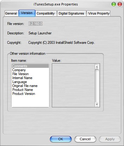

Same problem here. iTunes 4.6 will not install with the /s /v/qn.
As you can see from the attached picture, this is an InstallShield application.
Just use /s if you want the defaults, or create an iss by using /r /f1iTunes.iss

No, using /s does nothing. It silently fails.
  • Author
Quite correct. /s might as well mean silently fail.
