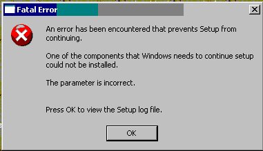

Now all 3 setups fail at 39min with the exact same error - see piccy.
The log file says
Error.
Installation Failed: E:\SETUP\RPXP\I386\asms. Error Message: The parameter is incorrect.
Fatal Error:
One of the components that Windows needs to continue could not be installed.
Has anyone seen this before or has any clue as to where I should look to correct the error? Remember the first 2 worked fine. Have now recompiled and tried 2nd ISO - just the same error.

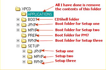

AAARGH! failure 6 or 7 times.
4) removed a folder from my build that contained optional apps for installation after UA is finished (Totally unconnected with UA and the integrated, silent apps.
5) again built ISO to empty drive.
It works again - but I don't know why!
