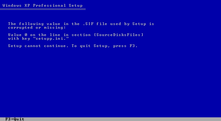

but I want to modify my txtsetup.sif
I want to modify the line
setupp.ini = 100,,,,,,_x,,3,3
to
setupp1.ini = 100,,,,,,_x,,3,3
am able to modify and save the line but when I reiso and vmware the ISO
I get the following please see attached file
Can someone please explain 100,,,,,,_x,,3,3 ?
