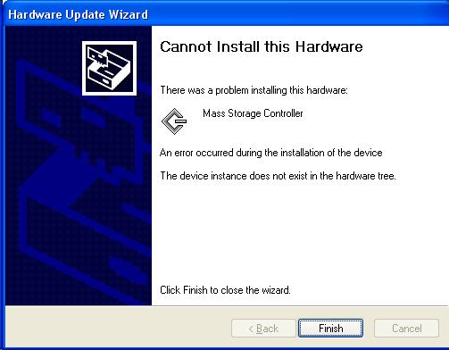

I'm having major prob's with a Silicon Image Sil 0680 raid controller in that I can't get it intalled in XP. I've tried the drivers which come with the card and also the latest ones I can find frim Silicon's website.
Everytime I go through the driver install I get an error that the data is invalid.
Well I'm stuck - Anyone got any idea's ?????

I also get this error when try to setup the card as a normal controller. Again I have tried a number of differnet drivers to get around - alas no luck
James
Do you have Sp1 installed, I have been using this card for over 12 months and have never had a problem with it in Windows XP. In Windows 2000, I had the problems described here and the only way I could get around it was to reinstall Windows 2000 and press F6 at the start of the text phase of the install and install the drivers then.
I certainly do have sp1 fow xp installed. I think I'll try Marsden option of a differnet PCI slot and then report back. I really don't want to have to rebuild :)

i use the attached dirvers and have no problems.
use in silent install as part of winnt.sif
since u got windows installed already windows key + pause break,
hardware,devie manager then right click on the device and go to udate drivers.
