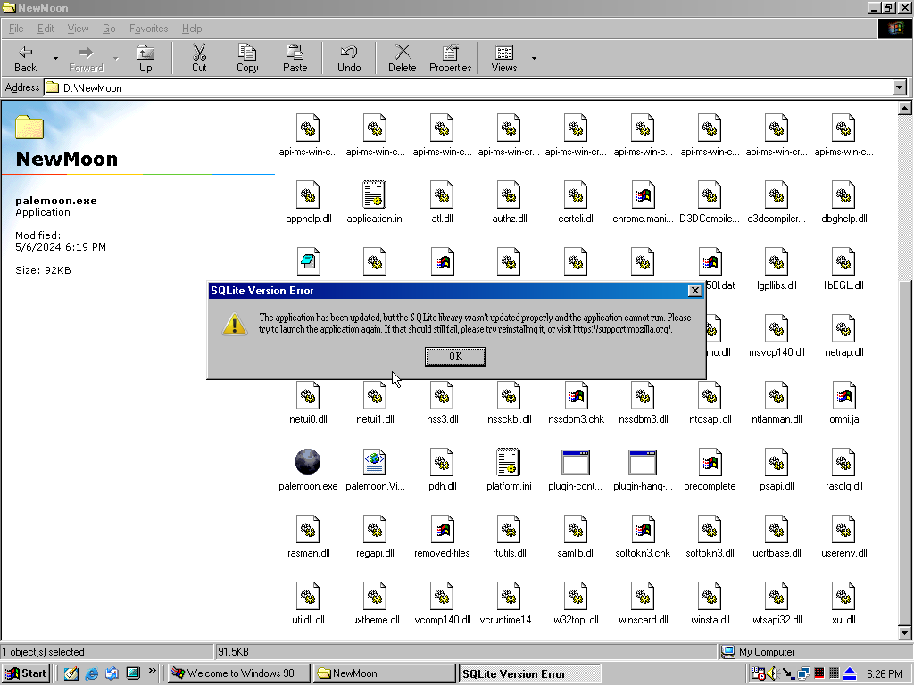

Iceburg Posted May 7, 2024 Author Posted May 7, 2024 Sorry for waiting so long but I actually got past "Couldn't load XPCOM." I get an error "The application was updated, but the SQLite library wasn't updated properly and the application cannot launch. Please try to launch the application again." followed by illegal operation 03h on xul.dll
Iceburg Posted May 7, 2024 Author Posted May 7, 2024 I got it working. The GetLastError method wasn't working for me. Had to stick to the Mypal method. Replacing 4.8.2 with 4.6.0 gave the sqlite error. but copying: - gkmedias.dll -omni.ja -mozsqlite3.dll -xul.dll -mozglue.dll from Mypal worked for me.
schwups Posted May 7, 2024 Posted May 7, 2024 You can also try [Kernel32.dll] RaiseException=v4 in your Kstub824/825.ini instead of the "GetLastError method", but it's system-wide and it may cause errors in other programs. But most should work. Reboot required. https://msfn.org/board/topic/181424-firefox-24-52-for-me-and-98/?do=findComment&comment=1251646
schwups Posted May 7, 2024 Posted May 7, 2024 (edited) I've taken a look at your screenshot. I have hardly tested all the dll's inside the program folder (it is a different approach), but Ucrtbase must in the system folder. Such files ATL and certcli aren't required and used here - therefore superfluous. And pdh and userenv are superfluous. too. These are part of KernelEx. "Mypal engine trick": I probably never tested 4.8.2 with 4.6.0. To clarify, it's basically Mypal with the look of Newmoon. Mypal 29.3 will soon be three years old and now it has significantly more infirmities than Newmoon or Serpent. Edited May 7, 2024 by schwups
