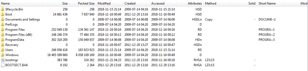

I'm pretty sure now that the download, although a seemingly a trustworthy source, was not direct from MS, as it had been until quite recently, and that the "install.wim" folder content structure has been modified for some reason.
This might be completely off the mark but it actually looks to me like somebody has taken authentic Win7 installer content and added files from an existing working PC, presumably running the specific Win 7 version required.

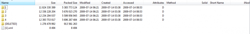

The problem is that from reference to my own genuine Win7 installer discs it appears that the "install.wim" archive, where the main OS content is located, needs those files to be packaged in a particular way: inside a numbered folder. In this download's case they're all loose.
Perhaps it would still install OK as it is but as far as the slipstreaming process goes it may not be usable.
Install.wim Content: download

Install.wim Content: org MS disc

I'm even more convinced now that the Win7 download I found whilst genuine is not correctly set up for the slipstreaming tools as it will not allow me to add the updates to the Win7 extracted ISO unless I identify the version as required. It simply does not recognise "Windows 7" as the version ID, reporting the path as invalid.
The downloaded ISO may well install Win7 correctly on its own but I'd have to add the updates separately as for my other Win7 PC. I do not mind doing that but as a backup a single disc with the Convenience Update Rollup included is a good idea which is why I wanted to do it.
So I've imported the relevant numbered install.wim file for the Win7 version I have a licence key for from my MS Win7 disc. I used that to replace the contents of the downloaded version's install.wim and checked that up to the point of adding the required Stack Update and Convenience Update Rollup. It identifies the Win7 version correctly in the way the slipstreaming tutorials describes/show so that's what I'm going to try.
