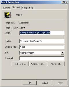

WwTIPPYwW Posted April 11, 2004 Posted April 11, 2004 Here is what I've got - I couldn't figure out how to set the install directory with the command switch. (its a WISE installer) If installed from "%ProgramFiles" it installs to c:\program files\AGENT just fine. However, the shortcuts pointed to C:\ so I had to fix those.the AGENT.INI is the main config.the LAYOUT.DAT is the layout.There are other files that could be loaded too, I just didn't grab them.If anyone knows how to pass the install DIR in the command line of the setup, I'd like to know. It would eliminate some of these extra steps in here. Also hopefully it would fix the shortcuts.Make your shortcuts look like the screenshot and you should be OK.cmdow @ /HID@echo offIF EXIST D:\CD.id set CDROM=D:IF EXIST E:\CD.id set CDROM=E:IF EXIST F:\CD.id set CDROM=F:IF EXIST G:\CD.id set CDROM=G:IF EXIST H:\CD.id set CDROM=H:IF EXIST I:\CD.id set CDROM=I:IF EXIST J:\CD.id set CDROM=J:xcopy /y %CDROM%\Software\agent20\setup.exe "%ProgramFiles%\"cd "%ProgramFiles%\""%ProgramFiles%\setup.exe" /sxcopy /y "%CDROM%\Software\agent20\agent.ini" "%ProgramFiles%\Agent\Data"xcopy /y "%CDROM%\Software\agent20\LAYOUT.DAT" "%ProgramFiles%\Agent\Data"xcopy /y "%CDROM%\Software\agent20\shortcuts\*.*" "%UserProfile%\Start Menu\Programs\Agent Newsreader"del "%ProgramFiles%\setup.exe"
