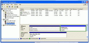

khonjo Posted May 2, 2004 Posted May 2, 2004 Please answer the following questions:1. Provide detail of how W98 was installed especially how drive letter became D:2. Partition information. See my previous post how to obtain it.3. Is there a boot.ini file at the root of D: drive?4. Post copy of Disk Manager display. The following is an example(My laptop pc).
Doggie Posted May 3, 2004 Posted May 3, 2004 i assigned it to D: myself.. there were 2 freshly formated partition, D: for w98 as i made it smaller in size, and C: for xptheres no boot.ini with w98's drivePartition Status Type SystemC: A Pri Dos Fat32 D: Ext Dos Fat32
khonjo Posted May 4, 2004 Posted May 4, 2004 Now, I see the whole picture. Here are your options to resolve the problem:1. This option requires starting from scratch: Install W98 in C: drive, then install WXP in D: drive. That is it. You will see OS selection menu durring boot-up process, and select one you want to boot.2. This option avoids reinstalling WXP but lot more complicated works involved: To do the following you need hard disk utility such as Partition Magic. 1) Resize the extended partition to make free space between the primary partition and the extended partition. 2) Create a new primary partition using the free space and format in FAT32. 3) Set the new primary partition active. 4) Boot to W98 Startup FD and install W98 in C: drive. Now you have WXP and W98 each is stand alone installation. To switch one OS to another I use boot manager utility called PQboot which comes with Partition Magic. Changing boot OS can also be done by switching acive partition using FDISK from W98 to WXP, and using Disk Manager of WXP from WXP to W98.To use the boot manager which is built in WXP, you need to create a file of W98 boot sector using one of the Windows Support Tools which is called dskprobe.exe. The setup files for the tools are in WXPCRROM\Support\Tools. The tools have to be installed to use. The boot sector file created need be stored at the root of WXP drive, and boot.ini file is edited using the name of the boot sector file.If you want to pursue setting up NT boot manager which will display boot option menu as 1. above, Which requires creating W98 boot sector file, post to that effect.
