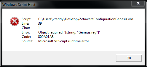

Hi,
Here is my vbscript which checks the computer name and then it'll run the registry key if the first 3 letters of machine code matches. But unfortunately it's not working. Please help me..

Your problem is this, the error means this is missing
'------------------------------' Run Registry if needed'------------------------------Set regFile = "Genesis.reg"
Here I redid the script so it a little more cleaner and added a FileExists check
'-> This code is property of Gunsmokingman and Or Jake1Eye and you must have his permission to use.'-> This is only posted as example code and meant only to used as such.'-> Objects For RuntimeDim Act :Set Act = CreateObject("WScript.Shell")Dim Fso :Set Fso = CreateObject("Scripting.FileSystemObject")'-> ComputerNameDim CName :CName = Act.ExpandEnvironmentStrings("%ComputerName%")'MsgBox CName,4128,"Test Computer Name"Dim IS_RUN_REGISTRY'-> Check For RegistryHACIf UCase(Left(CName,3)) = "HAC" ThenIS_RUN_REGISTRY = TrueElseIS_RUN_REGISTRY = FalseEnd If'-> If IS_RUN_REGISTRY = True And The Reg File ExistsIf Fso.FileExists("Genesis.reg") And IS_RUN_REGISTRY Then' Act.Run("regedit.exe /s " & Chr(34) & "Genesis.reg" & Chr(34)), 0, TrueMsgBox "Confirm Reg File"ElseIf Fso.FileExists("Genesis.reg") And IS_RUN_REGISTRY = False ThenMsgBox "ComputerName match was False",4128,"No Match ComputerName"ElseMsgBox "Missing Genesis.reg please make sure it in the" & vbCrLf &_"Genesis.reg is in the same folder as this script",4128,"Missing Reg File"End If
