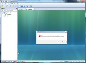

It manages to copy files and expand them, but upon restarting the system and being presented with the: "please wait while windows sets up your computer..." the vista installer loads and i'm presented with the message: error Windows could not start the installation process.

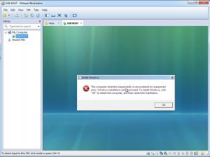

Upon reboot I am then presented with this: "The computer restarted unexpectedly or encountered an unexpected error. Windows installation cannot proceed. To install Windows, click "OK" to restart the computer, and then restart the installation. When clicking "Ok" the computer than enters a continues loop of death producing the latter error.

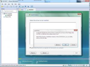

Attempting to load the vista iso loads the vista bootloader however I am presented with the error of: A required CD/DVD drive device driver is missing. If you have a driver floppy disk, cd, dvd, or usb flash drive, please insert it now.
