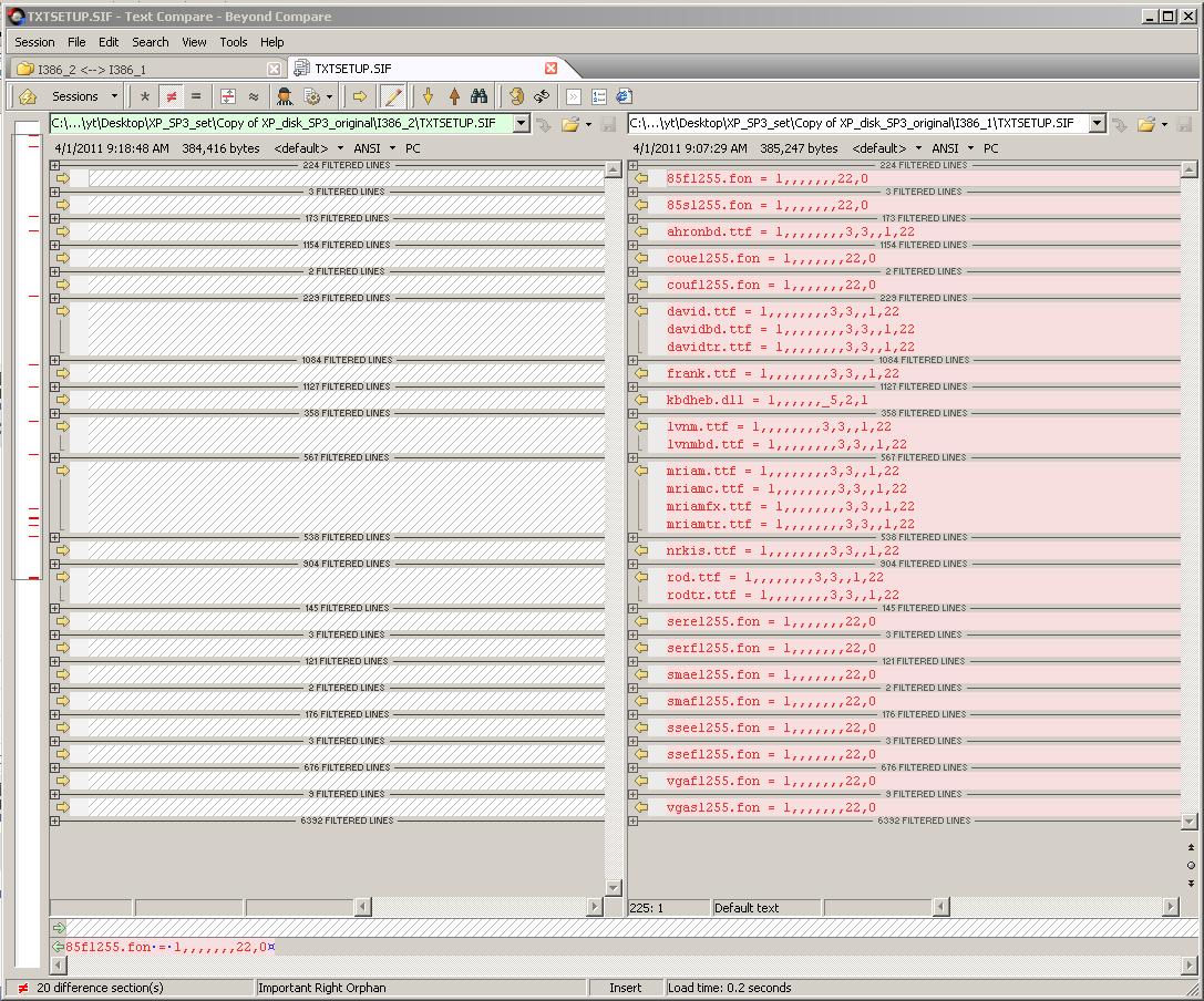

Just a note here, I am trying to recover both a missing language (Hebrew) and keyboard (Hebrew)
Here are the 2 screenshots:
Thanks.

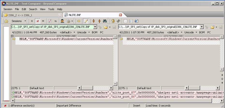

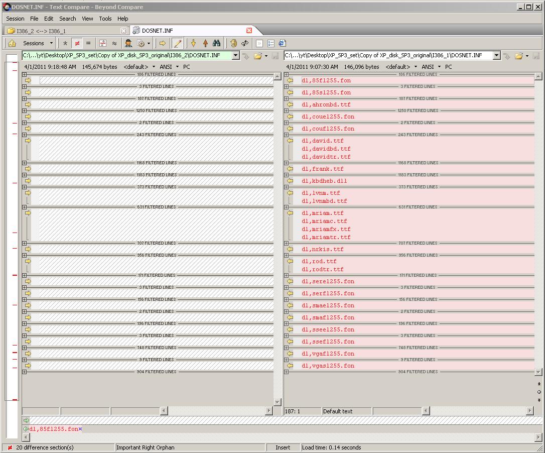

sorry about that, here it is.
I also saw your note in regards to the intl, I have swap the 2 files, but nothing have changed.
post-319938-0-00370400-1301672546_thumb.
OK, nlite.inf is nothing.
