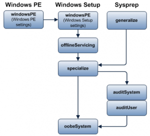

Posted (edited)
The order the passes run is something like:
1) windows PE
2) oobeSystem (reboot here)
3) specialize
4) audit user (reboot here - from last command)
5) oobeSystem again with UnattendedOOBE.xml
During auditUser the environment is setup, and programs can run just like they would after setup is finished. Input *could* be provided during auditUser pass but if you set up command-lines right then no input is necessary.
You just have to remove a few lines from UnattendedOOBE.xml (the reseal part) - process reboots from auditUser directly into OOBESystem step so it doesn't matter what you have in the other passes.
1) windows PE
3) specialize
where did you get that? I suggest you look at unattend.chm
depending on what you have added

I also place my taskbar editing scripts here so it applies to all newly created users.
Posted (edited)
Thanks I use a similar method now with RunOnce (starts a cmd file for every user) but the method I am testing (see post #39 and my post above yours) is much more *neat* and clean since tweaks and stuff will be applied to the default user, wich needs to be done only once.So I would really like this to work instead of going for a trick like I am using now....
I checked my xml above again for errors, couldnt find one :S
Edited by ZileXa
Posted (edited)
Investigated more, this command was not working:
[code<Path>cmd /c "FOR %i IN (C D E F G H I J K L N M O P Q R S T U V W X Y Z) DO IF EXIST %i:\UnattendedOOBE.xml SETX DVDRoot %i:"</Path>
So I am using my own command tested a while ago in a different topic.
That works. Now apps are installed!
I am now stuck at an error when executing SYSPREP.EXE (see my post above) the final command in Pass Audit User. The system doesn't reboot, I see a small window with a progess bar, sysprep doing something. Then it disappears and nothing happens:
<Path>C:\Windows\system32\sysprep\sysprep.exe /quiet /oobe /reboot /generalize /unattend:C:\AutoUnattendedOOBE.xml</Path>
