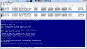

JoeHard Posted January 18, 2011 Author Posted January 18, 2011 Sorry for uploading useless information, I didn't know what would be useful to troubleshoot BSOD's.I have attached a screenshot of a utility that (hopefully) contains the error codes.If somebody has a clue about the problem please let me know! Thanks!
Tripredacus Posted January 19, 2011 Posted January 19, 2011 Ah fortunately, this is an easy to understand error! Well sort of. This error, IRQL_NOT_LESS_OR_EQUAL is a problem with a driver file, or with another program misusing the driver. The driver it calls out, nvlddmkm.sys is part of an nVidia video driver package. So things you can try: update the video drivers. You can try the one from nVidia or the one from Windows Update. One on WU showed up in Novemeber that fixed an issue I was having, but not the same as this. Also you can try turning Aero off if you have it on. My computer at work can't use Aero... it turns on but Windows locks up or gives errors. Also I noticed you have another error listed caused by cdrom.sys. You can try updating your chipset driver for that, but the only reason why I bring this up is because of that virus (can't find the actual name) that hides in the cdrom.sys. I battled a system late last year with a virus hidden in cdrom.sys, so just pointing that out.
