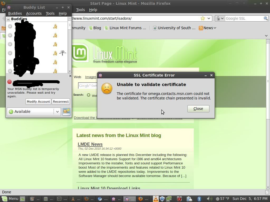

Pidgin MSN certificate problem (certificate error for omega​.con
I am sure there are several people having this problem with pidgin not being able to connect to MSN.
I have seen many solutions but I think this one is by far the easiest one to use.
http://www.webupd8.org/2010/11/fix-pidgin-msn-omegacontactsmsncom.html#more
1. Download this omega.contacts.msn.com certificate
http://webupd8.googlecode.com/files/omega.contacts.msn.com
2. In Pidgin, go to Tools > Certificates and remove the existing "omega.contacts.msn.com" certificate. Then select "Add" and add the certificate downloaded under step 1 and when prompted to enter the hostname, enter: "omega.contacts.msn.com":
Now click OK and that's it!
