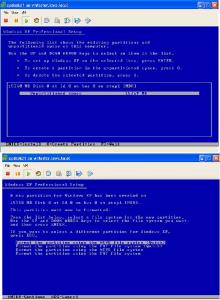

mikerowsopht Posted July 19, 2010 Posted July 19, 2010 (edited) Hi All, First off a big thanks to the creators of this site, it is by far the best website out there containing this kind of info and I wouldn't have been able to setup an unattended image with app install without MSFN so a big Thank You.My question is on my image the only part that is not now automated ( and I can't figure it out ) see attached image of my problemThere are 2 screenshots and I cannot automate it and don't know why, can anyone helpMy 2nd question is will my image create a differnet SID for each computer or will it create the same sid for every image ( which would cause me alot of problems )I am currently renaming the pc after image deployment but I hear that renaming a pc does not change the SID??below is my winnt.sif file which hopefully can show you experts where it is failing on the hard drive: ( removed passwords, etc.. )[Data]AutomaticUpdates="No"Autopartition=0MsDosInitiated=0UnattendedInstall="Yes"[Unattended]UnattendMode=FullUnattendedUnattendSwitch="Yes"OemPreinstall="Yes"OemSkipEula="Yes"ComputerType="Standard PC", RetailFileSystem=*WaitForReboot="No"NoWaitAfterTextMode=1NoWaitAfterGUIMode=1DriverSigningPolicy=IgnoreNonDriverSigningPolicy=IgnoreHibernation="No"[Display]Xresolution=1024Yresolution=768[SystemRestore]DisableSR=1CreateFirstRunRp=0[GuiUnattended]EncryptedAdminPassword="No"AutoLogon="Yes"AdminPassword="******"TimeZone=085OEMSkipRegional=1OemSkipWelcome=1[Shell]DefaultStartPanelOff="Yes"[Components]msmsgs=offmsnexplr=off freecell=offhearts=offminesweeper=offpinball=offsolitaire=offspider=offzonegames=off[UserData]ProductKey="**********************"ComputerName=PC999888FullName="admon"OrgName="****"[RegionalSettings]LanguageGroup=1SystemLocale="1809"UserLocale="1809"UserLocale_DefaultUser="1809"InputLocale="1809:00001809"InputLocale_DefaultUser="1809:00001809"[Networking]InstallDefaultComponents="Yes"[WindowsFirewall]Profiles=WindowsFirewall.TurnOffFirewall[WindowsFirewall.TurnOffFirewall]Mode=0[Identification]DomainAdmin=administratorDomainAdminPassword="*****"JoinDomain="domain.local"[GuiRunOnce]C:\install\start.cmd Edited July 20, 2010 by cluberti code tags

cluberti Posted July 19, 2010 Posted July 19, 2010 [Data]...AutoPartition=0...You've told it NOT to automate your disk setup right there - try these instead:[Data]...AutoPartition = 1...[Unattended]...ExtendOEMPartition = 1Filesystem = ConvertNTFSRepartition = YES...This will tell setup to automate partitioning, remove any existing partitions and repartition with one large partition/volume, and make sure it's the size of the drive (or as large as an NTFS filesystem can be).
mikerowsopht Posted July 19, 2010 Author Posted July 19, 2010 (edited) Hi jaclaz,I have read your link you provided on SIDS but don't know what to make of it to be honest. I would rather not take the chance if I can so was just wondering if my orignal winnt.sif file create's a different SID each time automatically during deployment or if it uses the same sid.********************************************************************************************Hi Cluberti,Thanks for the advice, I'll give it a try, should the code look like the below: ( edited from my orignal winnt.sif file )[Data]AutomaticUpdates="No"AutoPartition = 1 - autopartition = 1 or autopartition=1 ?? space in between = and 1, does this matter?ExtendOEMPartition = 1 - ExtendOEMPartition = 1 or ExtendOEMPartition=1 ?? space in between = and 1, does this matter?Filesystem = ConvertNTFSRepartition = YESMsDosInitiated=0UnattendedInstall="Yes"[Unattended]UnattendMode=FullUnattendedUnattendSwitch="Yes"OemPreinstall="Yes"etcetcetcThanks Again for the advice Edited July 20, 2010 by cluberti code tags
