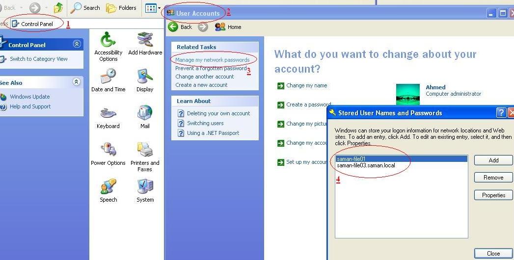

Hi,
I have some tricky problem you can see attachment, Possible to get solution from you Or your Freinds, If solved highly Appriciate to you.
Problem.
When ever restart the PC escaping(Un-Saved) username and password then i have to use again username and password to connect network resources folders (LAN).
Please see attachment below for more information
Regards,
Admin User
Usually passwords are saved correctly. So there should be a problem with your networks resources:
- use of two different logins for two shares one the same server (you have to use only one).
- use of two different passwords for the same share and with the same login.
First you'll need to remove all network connections :
- close all windows
- open a dos prompt and then type
net use * /d /y
and press enter.
Then you'll have to connect the needed shares and store the password when prompted (the first time without always reconnect check box).
