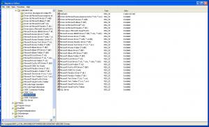

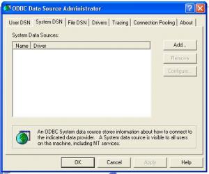

OK, I opened the 32 bit regestry with this %systemroot%\syswow64\regedit and went to this hive HKEY_LOCAL_MACHINE\Software\WOW6432Node\ODBC\ODBCINST.INI\ODBC Drivers. It says that all of the drivers are installed but they are not showing up in the ODBC.

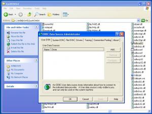

To view these, are you running the ODBC admin application directly from the .exe in the \Windows\SysWOW64 folder? I believe it's odbcad32.exe.
  • Author
Yes.
It's almost like it is still looking at the 64bit ODBC registry entries.
