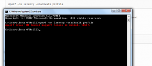

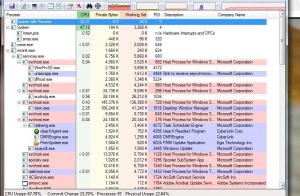

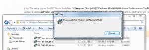

firedragon Posted August 5, 2013 Posted August 5, 2013 HI, I'm new to this forum as I have an issue with the NT Kernel eating over 50% of my CPU and its constantly maxed at 100%. I have read the tips here and have included the following print screens, I am hoping that someone can help me as this is a nightmare for me. I'm a total Noob at this sort of stuff and have tried to follow the instructions but am not getting something right.First i downloaded the Windows performance tools and there is a screen shot of this, then I downloaded xperf but when I try to run the commands in CMD i get the response in the cmd screen shot. Also I have changed the value in regedit as described to 1.please help and explain in laymans terms to me as i can not do the trace to get the help needed to sort it.also in cmd i can not change it to c:\temp as it says its not a correct internal or external commandalso when looking further into this thread another user was told to do this :- ( have you installed the wpt_x64.msi from the folder C:\Program Files\Microsoft SDKs\Windows\v7.0\bin? ) only i cannot find this in program fileshope you can understand this and help!Thanks in advance Tony

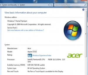

firedragon Posted August 5, 2013 Posted August 5, 2013 oh yeah sorry here is my system profileThanksTony
MagicAndre1981 Posted August 5, 2013 Author Posted August 5, 2013 you must open the cmd.exe as admin:http://windows.microsoft.com/en-US/windows7/How-do-I-run-an-application-once-with-a-full-administrator-access-token
firedragon Posted August 5, 2013 Posted August 5, 2013 you must open the cmd.exe as admin:http://windows.microsoft.com/en-US/windows7/How-do-I-run-an-application-once-with-a-full-administrator-access-tokenim the only user set on this pc, wouldnt that make me the admin?
firedragon Posted August 5, 2013 Posted August 5, 2013 you must open the cmd.exe as admin:http://windows.microsoft.com/en-US/windows7/How-do-I-run-an-application-once-with-a-full-administrator-access-tokenim only user and account set to administrator on the pc. what am i not doing right?
