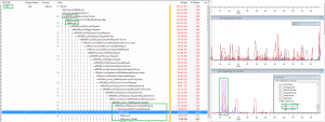

MagicAndre1981 Posted August 31, 2012 Author Posted August 31, 2012 your issue is now the Saffire.sys which belongs to your MIDI device:Is 4.0.0.13485 the latest driver version?

doveman Posted September 1, 2012 Posted September 1, 2012 OK, so I started the trace withD:\>xperf -on latency -stackwalk profile -buffersize 1024 -MaxFile 256 -FileMode Circular && timeout -1 && xperf -d interrupt.etllet it run for about 30s, then started TVservice.exe, which takes about 30s to start. I'm not sure how much time gets captured in 256MB but I left it running for about 5 minutes which should hopefully have caught the USBPORT.sys spikes.It created a kernel.etl and DPC_Interrupt.etl. I think from memory you only need the latter but please let me know if you want me to upload the kernel.etl as well.http://www.mediafire.com/?7xoaddbpg99un0f
MagicAndre1981 Posted September 1, 2012 Author Posted September 1, 2012 the mouse causes the USBport.sys issues:try to to connect the mouse to a different port.
doveman Posted September 1, 2012 Posted September 1, 2012 the mouse causes the USBport.sys issues:try to to connect the mouse to a different port.Thanks, that seems to have fixed it. With TV playing (obviously with TVservice.exe running) I haven't had any USBPORT.sys DPC spikes since disconnecting the mouse from my USB hub and connecting it directly to a port on the motherboard (via an extension cable as my PC is about 5m from my desk). I'll test later without TV playing just to be sure, as that was how I was testing before but I doubt it will be worse when idle.I can't pretend to understand the image you posted, nor why the mouse connected to the hub would only cause DPC spikes when TVservice.exe is running. Could you explain a bit so I can hopefully learn how to avoid similar issues in future?

davros303 Posted September 2, 2012 Posted September 2, 2012 Hi again Andre,I just disconnected and uninstalled the driver software for the Focusrite Saffire and the same intermittent DPC spikes are occuring, USBPORT.SYS seems to be doing the dirty work here. http://www.mediafire.com/?q2mrrs9bwztsc7yGoing to try swapping usb ports for the various peripherals. By the way, how do you configure settings to get that particular view from the performance toolkit that you've been posting screenshots of? eg: where you idenfied the Saffire.sys reference.All the best,Davros
MagicAndre1981 Posted September 2, 2012 Author Posted September 2, 2012 this time I see spikes of the AI Charger software of ASUSYou can get the view, by looking at the "summary table" of the "CPU sampling per process" and arrange the columns like I did.

davros303 Posted September 3, 2012 Posted September 3, 2012 Hi Andre,I'm running the latest Asus drivers for that mobo. The AI utility is an "optional" add-on to optimise settings etc which loads automatically at startup. I'll try uninstalling it and see what happens.All the best,Davidthis time I see spikes of the AI Charger software of ASUSYou can get the view, by looking at the "summary table" of the "CPU sampling per process" and arrange the columns like I did.
